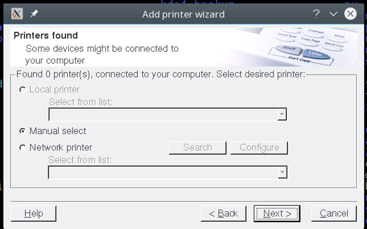

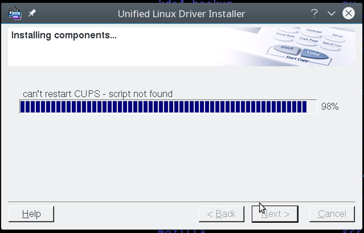

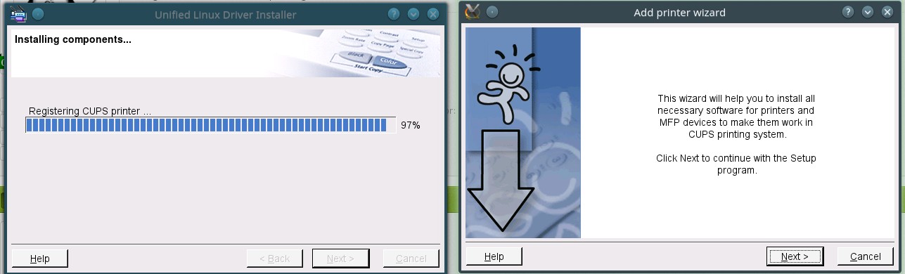

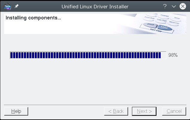

    linux-r24d:/home/moritz/samsung/cdroot # ./autorun
    libstdc++.so.5 (gcc 3.0.x .. 3.3.x) not found, install ... done
    libtiff.so.3 not found, install ... done
    ****  It seems Qt library is not installed, or X display is not accessible.
    ****  Custom Qt library will be configured for use with this package.
    ... und dann moniert der Samsung-Installer, es sei kein Drucker angeschlossen.
