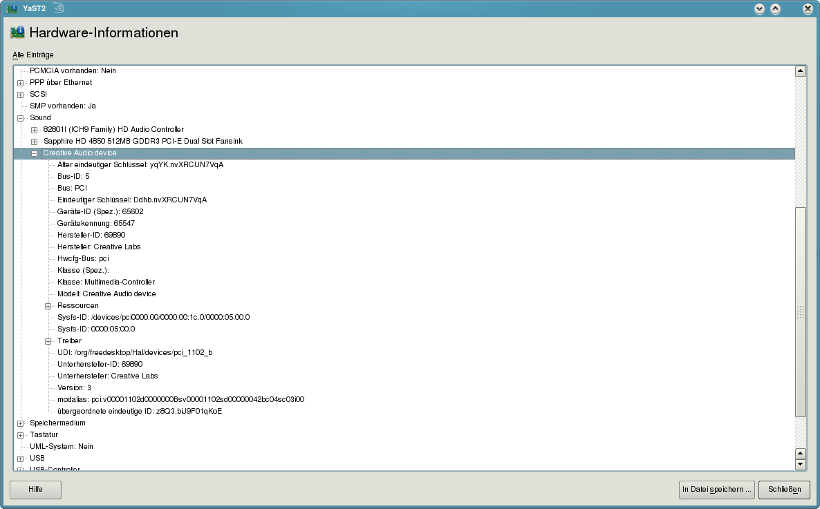

alsa-plugins-1.0.18-6.13hwinfo --sound
ZitatAlles anzeigen28: PCI 100.1: 0403 Audio device
[Created at pci.318]
UDI: /org/freedesktop/Hal/devices/pci_1002_aa30
Unique ID: NXNs.h2kiZ7VIR82
Parent ID: vSkL.5bwg2ZLS1L1
SysFS ID: /devices/pci0000:00/0000:00:01.0/0000:01:00.1
SysFS BusID: 0000:01:00.1
Hardware Class: sound
Model: "PC Partner Sapphire HD 4850 512MB GDDR3 PCI-E Dual Slot Fansink"
Vendor: pci 0x1002 "ATI Technologies Inc"
Device: pci 0xaa30 "HD48x0 audio"
SubVendor: pci 0x174b "PC Partner Limited"
SubDevice: pci 0xaa30 "Sapphire HD 4850 512MB GDDR3 PCI-E Dual Slot Fansink"
Memory Range: 0xfccfc000-0xfccfffff (rw,non-prefetchable)
IRQ: 17 (no events)
Module Alias: "pci:v00001002d0000AA30sv0000174Bsd0000AA30bc04sc03i00"
Driver Info #0:
Driver Status: snd_hda_intel is not active
Driver Activation Cmd: "modprobe snd_hda_intel"
Config Status: cfg=no, avail=yes, need=no, active=unknown
Attached to: #9 (PCI bridge)29: PCI 500.0: 0403 Audio device
UDI: /org/freedesktop/Hal/devices/pci_1102_b
Unique ID: Ddhb.nvXRCUN7VqA
Parent ID: z8Q3.biJ9F01qKoE
SysFS ID: /devices/pci0000:00/0000:00:1c.0/0000:05:00.0
SysFS BusID: 0000:05:00.0
Model: "Creative Audio device"
Vendor: pci 0x1102 "Creative Labs"
Device: pci 0x000b
SubVendor: pci 0x1102 "Creative Labs"
SubDevice: pci 0x0042
Revision: 0x03
Memory Range: 0xfeaf0000-0xfeafffff (rw,non-prefetchable)
Memory Range: 0xfe800000-0xfe9fffff (rw,non-prefetchable)
Memory Range: 0xfd000000-0xfdffffff (rw,non-prefetchable)
IRQ: 11 (no events)
Module Alias: "pci:v00001102d0000000Bsv00001102sd00000042bc04sc03i00"
Driver Info #0:
Driver Status: ctxfi is active
Driver Activation Cmd: "modprobe ctxfi"
Attached to: #14 (PCI bridge)head -n 1 /proc/asound/card0/codec*
