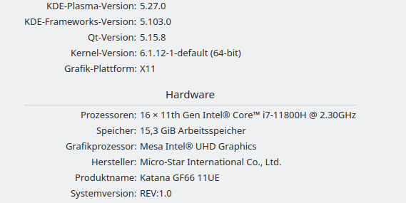

    Zweites Problem: (Screenshot)...

    sudo lspci -nnk | grep -A3 VGA
    0000:00:02.0 VGA compatible controller [0300]: Intel Corporation TigerLake-H GT1 [UHD Graphics] [8086:9a60] (rev 01)
    DeviceName: Onboard - Video
    Subsystem: Micro-Star International Co., Ltd. [MSI] Device [1462:12ea]
    Kernel driver in use: i915
    0000:01:00.0 VGA compatible controller [0300]: NVIDIA Corporation GA106M [GeForce RTX 3060 Mobile / Max-Q] [10de:2520] (rev a1)
    Kernel modules: nouveau
    0000:02:00.0 Ethernet controller [0200]: Realtek Semiconductor Co., blablabla
