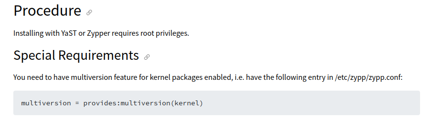

    SDB:NVIDIA SUSE Prime - openSUSE Wiki
