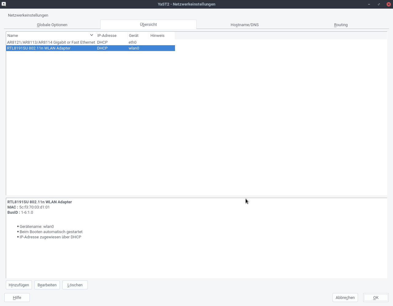

alles mit eingestecktem Kabel .. wenn ohne (ist ziemlich kompliziert) bitte nochmal melden
Codesystemctl status wicked ● wicked.service - wicked managed network interfaces Loaded: loaded (/usr/lib/systemd/system/wicked.service; disabled; vendor preset: disabled) Active: inactive (dead)Code
Alles anzeigenNetworkManager.service - Network Manager Loaded: loaded (/usr/lib/systemd/system/NetworkManager.service; enabled; vendor preset: disabled) Drop-In: /usr/lib/systemd/system/NetworkManager.service.d └─NetworkManager-ovs.conf Active: active (running) since Sat 2018-10-20 11:44:07 CEST; 3h 0min ago Docs: man:NetworkManager(8) Main PID: 1185 (NetworkManager) Tasks: 4 (limit: 4915) CGroup: /system.slice/NetworkManager.service ├─1185 /usr/sbin/NetworkManager --no-daemon └─4589 /sbin/dhclient -d -q -sf /usr/lib/nm-dhcp-helper -pf /var/run/dhclient-eth0.pid -lf /var/lib/NetworkManager/dhclient-f9d9a608-0ad5-34a6-a5c5-> Oct 20 14:33:15 linux-w5fn NetworkManager[1185]: <info> [1540038795.5415] device (wlan0): supplicant interface state: inactive -> disconnected Oct 20 14:33:15 linux-w5fn NetworkManager[1185]: <info> [1540038795.5450] device (wlan0): supplicant interface state: disconnected -> inactive Oct 20 14:34:09 linux-w5fn NetworkManager[1185]: <info> [1540038849.5212] manager: NetworkManager state is now CONNECTED_GLOBAL Oct 20 14:38:30 linux-w5fn NetworkManager[1185]: <info> [1540039110.5103] device (wlan0): set-hw-addr: set MAC address to 12:A3:17:87:A9:C1 (scanning) Oct 20 14:38:30 linux-w5fn NetworkManager[1185]: <info> [1540039110.5428] device (wlan0): supplicant interface state: inactive -> disconnected Oct 20 14:38:30 linux-w5fn NetworkManager[1185]: <info> [1540039110.5568] device (wlan0): supplicant interface state: disconnected -> inactive Oct 20 14:39:38 linux-w5fn NetworkManager[1185]: <info> [1540039178.4548] connectivity: (eth0) timed out Oct 20 14:39:38 linux-w5fn NetworkManager[1185]: <info> [1540039178.4549] manager: NetworkManager state is now CONNECTED_SITE Oct 20 14:43:45 linux-w5fn NetworkManager[1185]: <info> [1540039425.5107] device (wlan0): set-hw-addr: set MAC address to EE:8F:6B:20:71:EA (scanning) Oct 20 14:44:08 linux-w5fn NetworkManager[1185]: <info> [1540039448.5126] manager: NetworkManager state is now CONNECTED_GLOBAL lines 1-22/22 (END) -

es müsste .. mit anderen Rechner tut es auch. Hier nicht.
Wenn ich im Aplett auf 'verbinden' klicke erscheint 'schnittstelle wird eingerichtet' und dann ist wieder nicht: keine Verbindung
wlan-nic muss doch in Ordnung sein - wenn die Netzwerke erscheinen.Manchmal erscheint nach dem 'verbinden-Click' eine Box: Es 'muss unten ein passwort eingegeben werden' (unten .. wo ist das .. )
aber egal ob ich die Passphrase für den Zugang oder mein Schlüsselbund-Passwort eingebe: klappt nicht. -

nmcli -p g
Hier war alles außer wwan ok.
