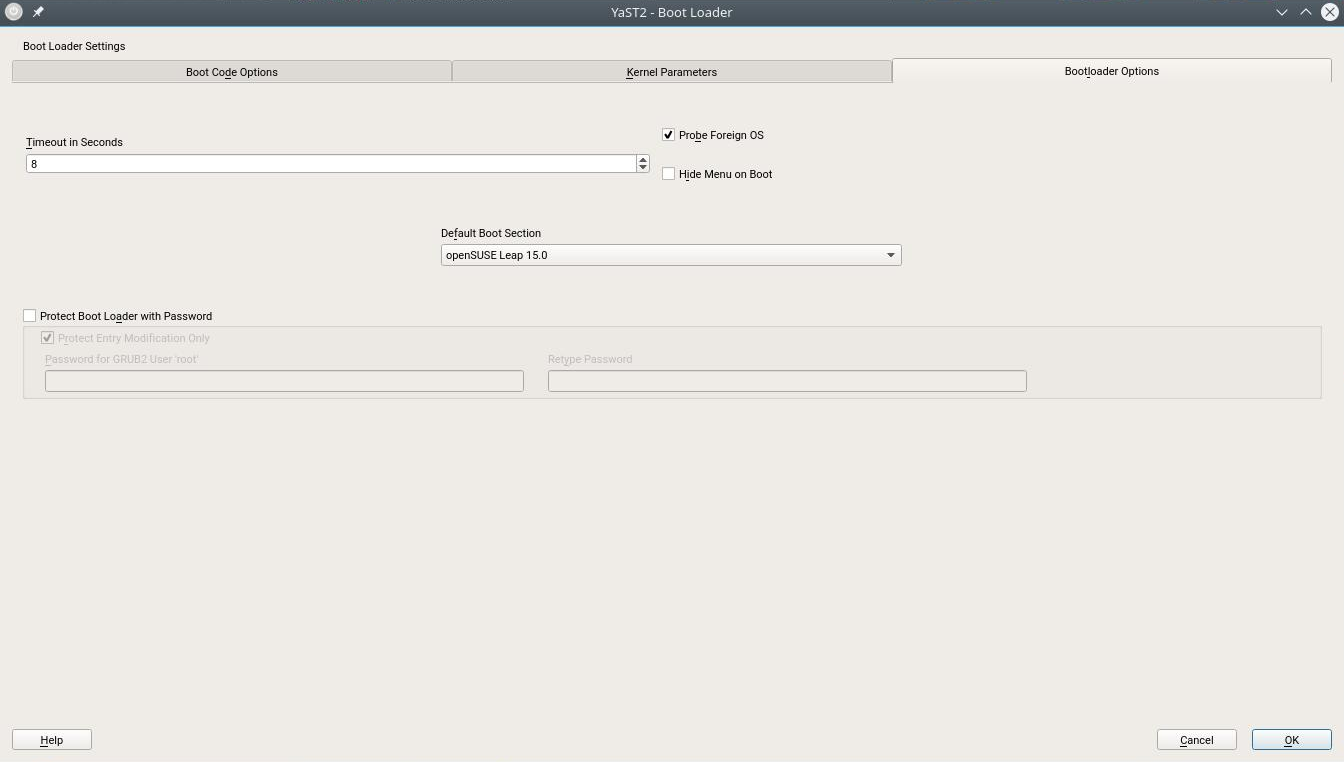

  • Grüß dich,
    ist der Haken bei Yast -> Bootloader -> Bootloader Optionen -> Fremdes OS testen gesetzt?

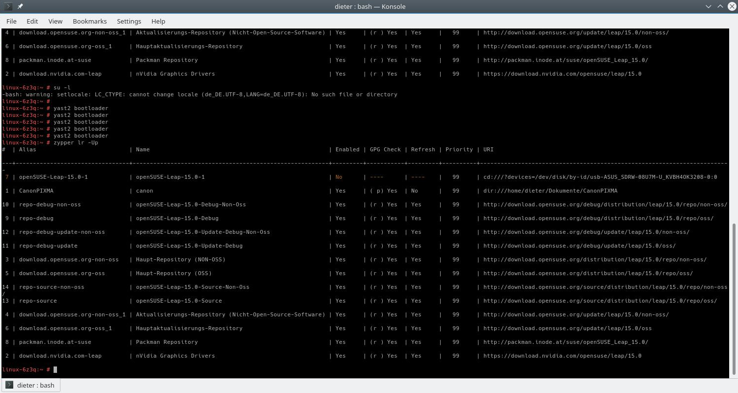

  • Hallo Egostra:
    das sind die Repos
    zypper lr -Up
    # | Alias | Name | Enabled | GPG Check | Refresh | Priority | URI
    7 | openSUSE-Leap-15.0-1 | openSUSE-Leap-15.0-1 | No | ---- | ---- | 99 | cd:///?devices=/dev/disk/by-id/usb-ASUS_SDRW-08U7M-U_KVBH4OK3208-0:0
    1 | CanonPIXMA | canon | Yes | ( p) Yes | No | 99 | dir:///home/dieter/Dokumente/CanonPIXMA
    10 | repo-debug-non-oss | openSUSE-Leap-15.0-Debug-Non-Oss | Yes | (r ) Yes | Yes | 99 | Index of /debug/distribution/leap/15.0/repo/non-oss
    9 | repo-debug | openSUSE-Leap-15.0-Debug | Yes | (r ) Yes | Yes | 99 | Index of /debug/distribution/leap/15.0/repo/oss
    12 | repo-debug-update-non-oss | openSUSE-Leap-15.0-Update-Debug-Non-Oss | Yes | (r ) Yes | Yes | 99 | Index of /debug/update/leap/15.0/non-oss
    11 | repo-debug-update | openSUSE-Leap-15.0-Update-Debug | Yes | (r ) Yes | Yes | 99 | Index of /debug/update/leap/15.0/oss
    3 | download.opensuse.org-non-oss | Haupt-Repository (NON-OSS) | Yes | (r ) Yes | Yes | 99 | Index of /distribution/leap/15.0/repo/non-oss
    5 | download.opensuse.org-oss | Haupt-Repository (OSS) | Yes | (r ) Yes | Yes | 99 | Index of /distribution/leap/15.0/repo/oss
    14 | repo-source-non-oss | openSUSE-Leap-15.0-Source-Non-Oss | Yes | (r ) Yes | Yes | 99 | Index of /source/distribution/leap/15.0/repo/non-oss
    13 | repo-source | openSUSE-Leap-15.0-Source | Yes | (r ) Yes | Yes | 99 | Index of /source/distribution/leap/15.0/repo/oss
    4 | download.opensuse.org-non-oss_1 | Aktualisierungs-Repository (Nicht-Open-Source-Software) | Yes | (r ) Yes | Yes | 99 | Index of /update/leap/15.0/non-oss
    6 | download.opensuse.org-oss_1 | Hauptaktualisierungs-Repository | Yes | (r ) Yes | Yes | 99 | Index of /update/leap/15.0/oss
    8 | packman.inode.at-suse | Packman Repository | Yes | (r ) Yes | Yes | 99 | Index of /suse/openSUSE_Leap_15.0/
    2 | download.nvidia.com-leap | nVidia Graphics Drivers | Yes | (r ) Yes | Yes | 99 | Index of /opensuse/leap/15.0
    Hallo Sauerländer:
    su -l
    -bash: warning: setlocale: LC_CTYPE: cannot change locale (de_DE.UTF-8,LANG=de_DE.UTF-8): No such file or directory
    rufe ich dann yast2 bootloader kommt in grafischer Oberfläche die Einstellung des bootloaders...

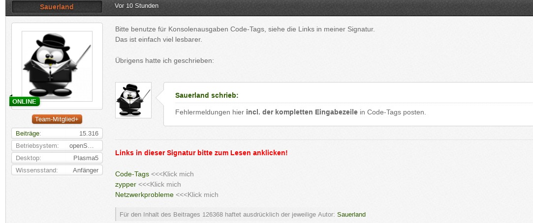

  • Bitte benutze für Konsolenausgaben Code-Tags, siehe die Links in meiner Signatur.
    Das ist einfach viel lesbarer.
    Übrigens hatte ich geschrieben:
    Sauerland schrieb:
    Fehlermeldungen hier incl. der kompletten Eingabezeile in Code-Tags posten.
    Code-Tags <<<Klick mich
    zypper <<<Klick mich
    Für den Inhalt des Beitrages 126368 haftet ausdrücklich der jeweilige Autor: Sauerland

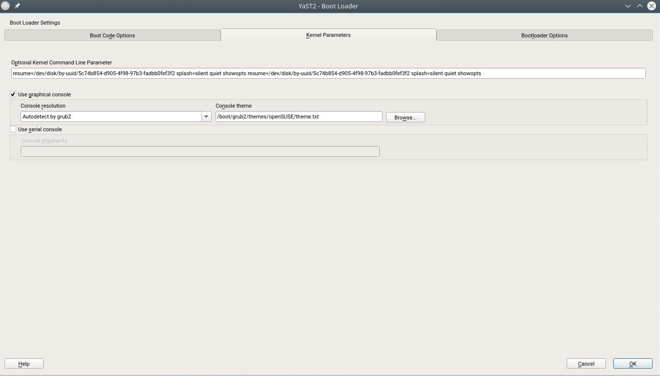

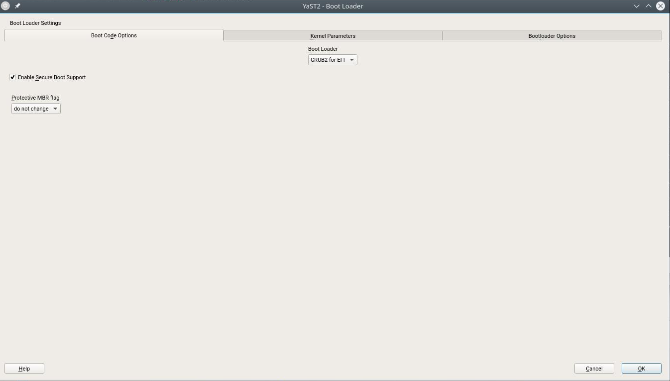

  • Hallo Sauerland
    sorry für die Verzögerung, hoffe, ich hab die Code-Tags richtig gemacht
    Bilder
      67,48 kB, 1.346×765, 17 mal angesehen
      112,44 kB, 1.344×765, 14 mal angesehen
      88,98 kB, 1.344×762, 14 mal angesehen
      457,92 kB, 1.502×800, 11 mal angesehen
    Für den Inhalt des Beitrages 126372 haftet ausdrücklich der jeweilige Autor: jobo
