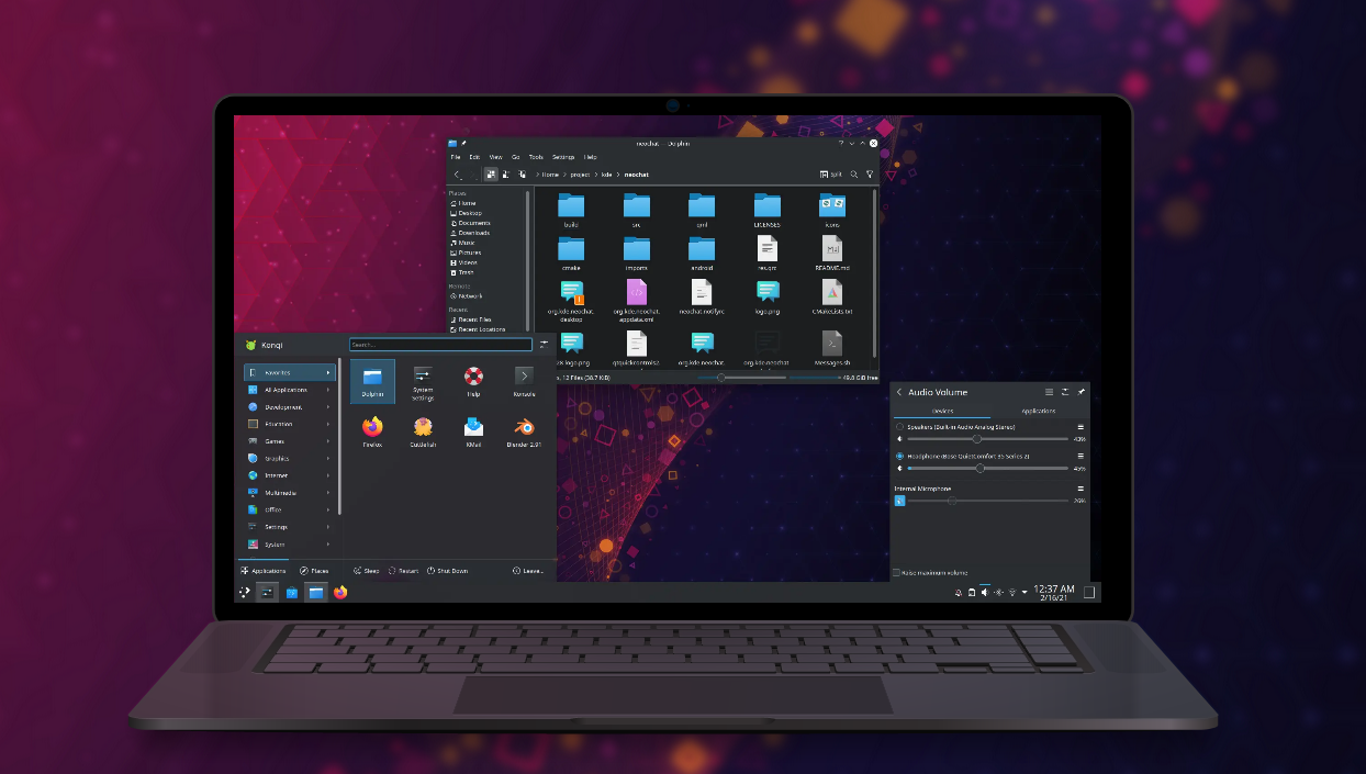

  • Über welches Repository wird die Beta angeboten?
    KDE Plasma 5.24.90, beta Release
    This is a beta release of KDE Plasma, featuring Plasma Desktop and other essential software for your computer.
    kde.org
    Plasma 5.25 Beta
    KDE Ships Plasma 5.25 Beta.
    kde.org
