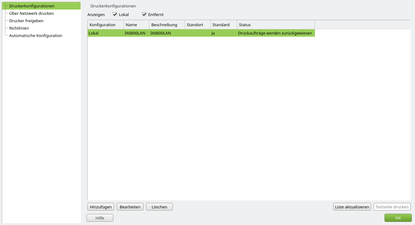

Ich habe es immer noch nicht geschafft. Nun habe ich den Drucker per USB direkt am Rechner angeschlossen. Beim Ausführen der Installationsroutine passiert das Gleiche. Breche ich den Vorgang mit Strg C ab, so kommt die Meldung, ich solle es mit lpadmin selbst machen:
Alles anzeigenKarla:/home/ulrich/Dokumente/Pixma/cnijfilter-ix6800series-4.10-1-rpm # ./install.sh ================================================== Canon Inkjet Printer Driver Version 4.10 Copyright CANON INC. 2001-2014 ================================================== Command executed = rpm --test -U ./packages/cnijfilter-common-4.10-1.x86_64.rpm package cnijfilter-common-4.10-1.x86_64 is already installed Command executed = rpm --test -U ./packages/cnijfilter-ix6800series-4.10-1.x86_64.rpm package cnijfilter-ix6800series-4.10-1.x86_64 is already installed #=========================================================# # Register Printer #=========================================================# Next, register the printer to the computer. Connect the printer, and then turn on the power. To use the printer on the network, connect the printer to the network. When the printer is ready, press the Enter key. > #=========================================================# # Connection Method #=========================================================# 1) USB 2) Network Select the connection method.[1] Searching for printers... #=========================================================# # Select Printer #=========================================================# Select the printer. If the printer you want to use is not listed, select Update [0] to search again. To cancel the process, enter [Q]. ----------------------------------------------------------- 0) Update ----------------------------------------------------------- Target printers detected 1) Canon iX6800 series (//Canon/?port=usb&serial=118535) ----------------------------------------------------------- Currently selected:[1] Canon iX6800 series (//Canon/?port=usb&serial=118535) Enter the value. [1] #=========================================================# # Register Printer #=========================================================# Enter the printer name.[IX6800USB] Command executed = /usr/sbin/lpadmin -p IX6800USB -P /usr/share/cups/model/canonix6800.ppd -v cnijbe://Canon/?port=usb&serial=118535 -E lpadmin: Nicht berechtigt The printer registration has not been completed. Register the printer manually by using the lpadmin command.Mit dem Befehl lpadmin komme ich nicht zurecht. Ich finde auch nirgendwo eine brauchbare Erklärung dazu. Warum bin ich da nicht berechtigt, selbst wenn ich als root angemeldet bin?

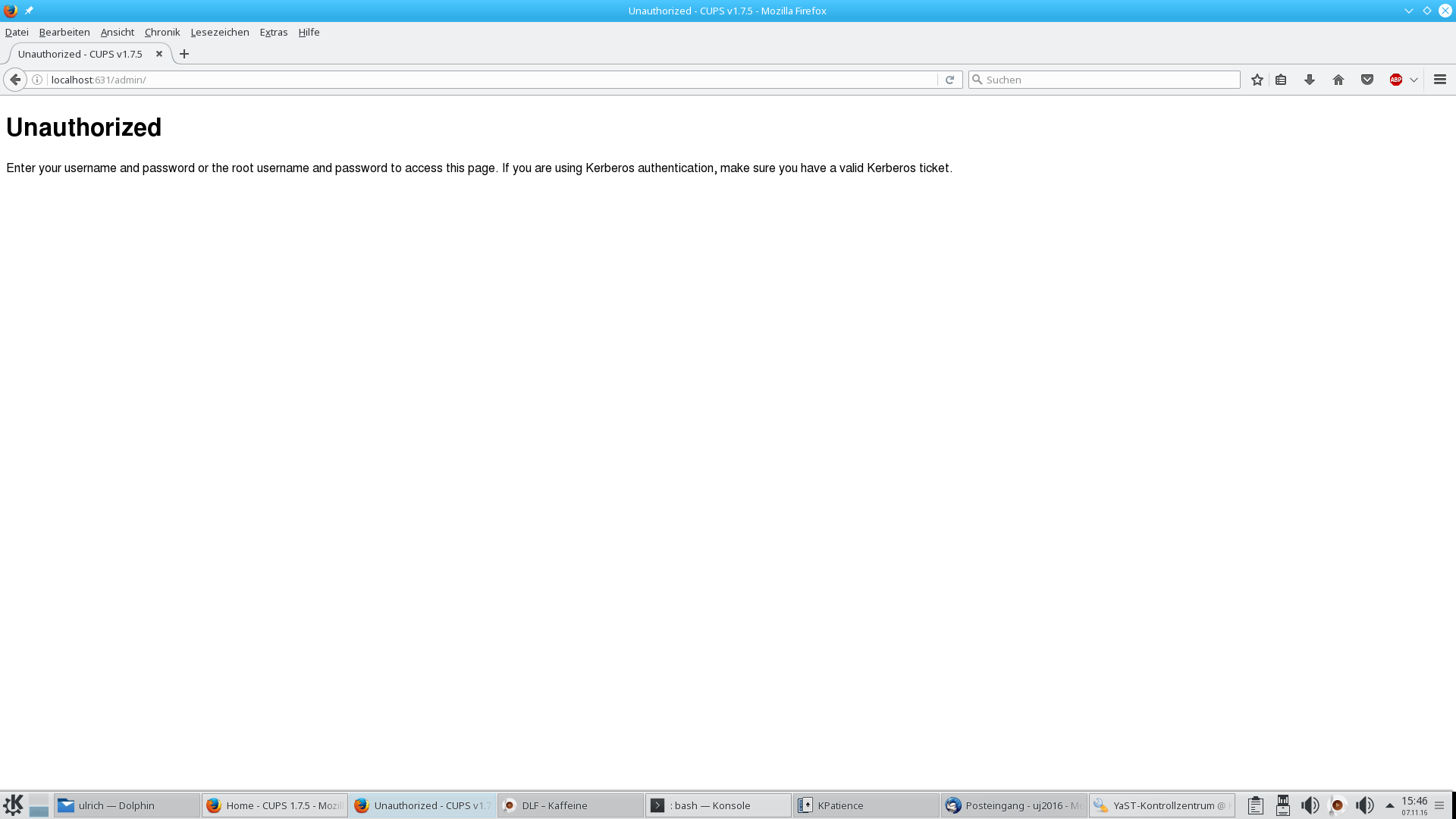

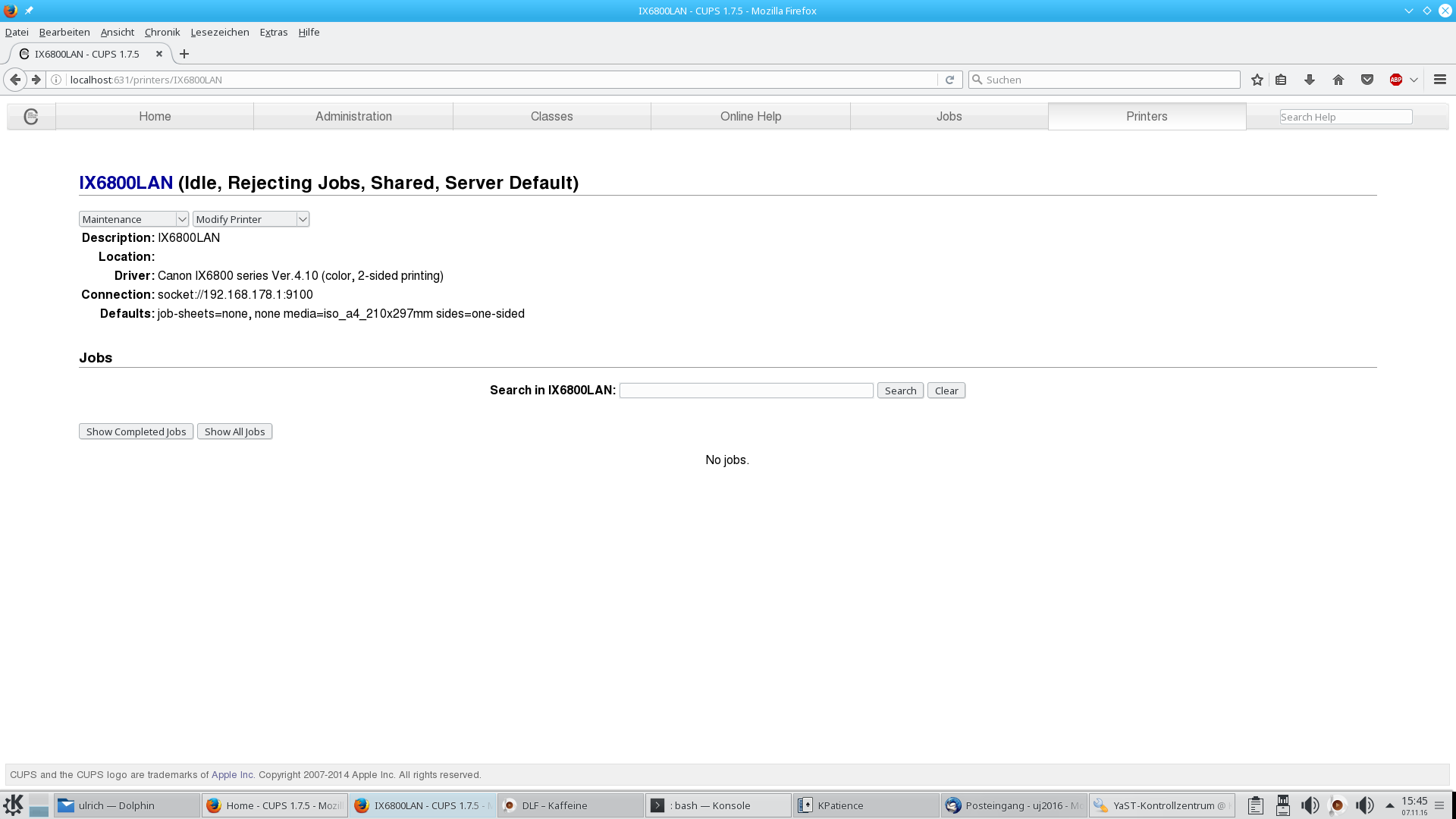

Du kannst es dir einfacher machen, wenn du einfach in den Browser deiner Wahl die Adresse http://localhost:631 eingibst.

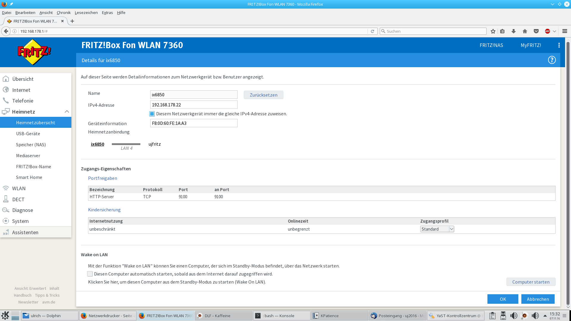

Cups hat einen eingebauten Webserver mit Verwaltung aller Drucker und Queues.Mit Fritzboxen gab es häufig schon Probleme einen Netzwerkdrucker zu betreiben, da die Fritzbox hier wohl (zumindest bei einigen Modellen) andere Wege gehen will. Hatten wir hier schon öfter.
