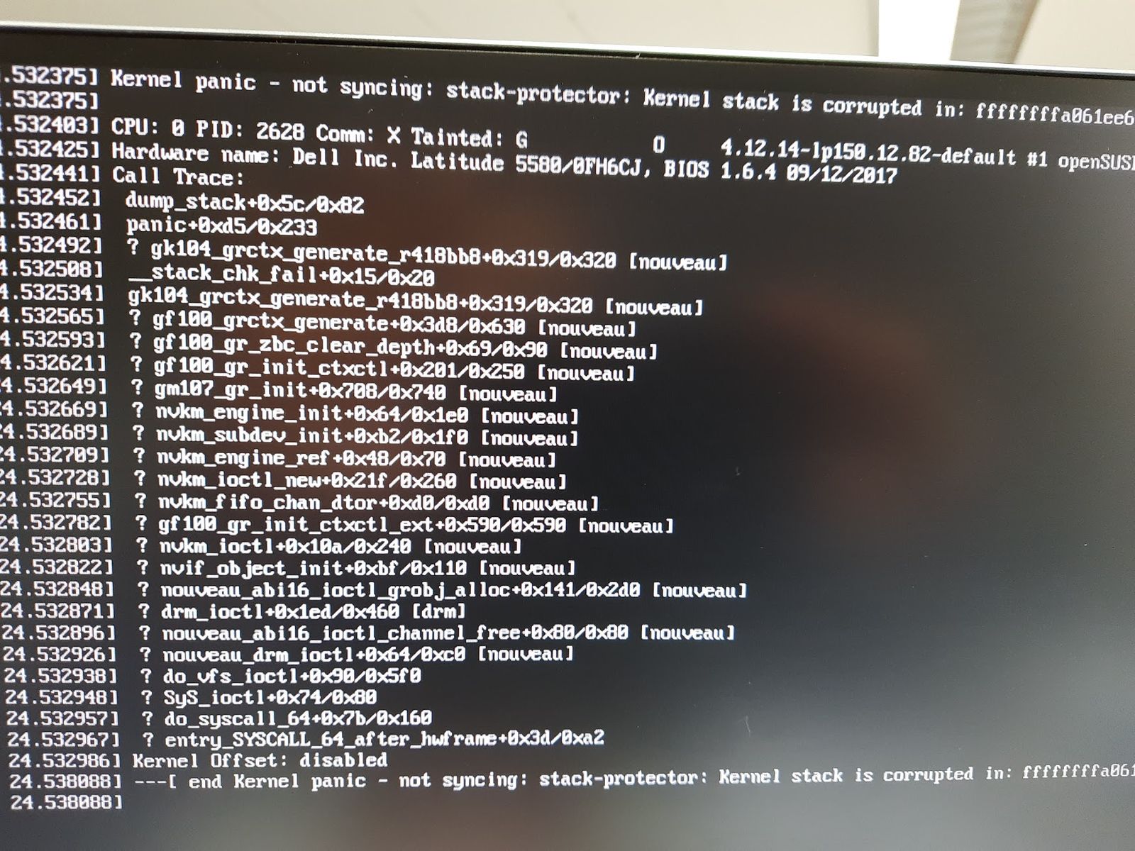

Ich habe versucht mein Suse von 42.3 auf 15.0 zu aktualisieren.

OK. Ich bin kein Hellseher aber kernel panic geht meistens auf GRAKA Konto
Was für eine Grafikkarte ist im Spiel? -

Alles anzeigenhwinfo --gfxcard 09: PCI 02.0: 0300 VGA compatible controller (VGA) [Created at pci.386] Unique ID: _Znp.LHvr6LldLQF SysFS ID: /devices/pci0000:00/0000:00:02.0 SysFS BusID: 0000:00:02.0 Hardware Class: graphics card Device Name: "Onboard IGD" Model: "Intel HD Graphics 630" Vendor: pci 0x8086 "Intel Corporation" Device: pci 0x591b "HD Graphics 630" SubVendor: pci 0x1028 "Dell" SubDevice: pci 0x07d1 Revision: 0x04 Driver: "i915" Driver Modules: "i915" Memory Range: 0xeb000000-0xebffffff (rw,non-prefetchable) Memory Range: 0x80000000-0x8fffffff (ro,non-prefetchable) I/O Ports: 0xf000-0xf03f (rw) IRQ: 135 (161638 events) I/O Ports: 0x3c0-0x3df (rw) Module Alias: "pci:v00008086d0000591Bsv00001028sd000007D1bc03sc00i00" Driver Info #0: Driver Status: i915 is active Driver Activation Cmd: "modprobe i915" Config Status: cfg=no, avail=yes, need=no, active=unknown 26: PCI 100.0: 0302 3D controller [Created at pci.386] Unique ID: VCu0.iHaECT_3+U3 Parent ID: vSkL.Z_mVVAIISK4 SysFS ID: /devices/pci0000:00/0000:00:01.0/0000:01:00.0 SysFS BusID: 0000:01:00.0 Hardware Class: graphics card Model: "nVidia GM107 [GeForce 940MX]" Vendor: pci 0x10de "nVidia Corporation" Device: pci 0x179c "GM107 [GeForce 940MX]" SubVendor: pci 0x1028 "Dell" SubDevice: pci 0x07d1 Revision: 0xa2 Driver: "nouveau" Driver Modules: "drm" Memory Range: 0xec000000-0xecffffff (rw,non-prefetchable) Memory Range: 0xc0000000-0xcfffffff (ro,non-prefetchable) Memory Range: 0xd0000000-0xd1ffffff (ro,non-prefetchable) I/O Ports: 0xe000-0xefff (rw) Memory Range: 0xed000000-0xed07ffff (ro,non-prefetchable,disabled) IRQ: 132 (46 events) Module Alias: "pci:v000010DEd0000179Csv00001028sd000007D1bc03sc02i00" Driver Info #0: Driver Status: nouveau is active Driver Activation Cmd: "modprobe nouveau" Config Status: cfg=no, avail=yes, need=no, active=unknown Attached to: #8 (PCI bridge) Primary display adapter: #9 -

Du hast dort Intel und Nvidia.
Versuche nomodeset beim Booten

Du hast zwei GRAKA.

Naja, dass die Graka Schwierigkeiten macht, sieht man ja an den Fehlermeldungen. Alles Nouveau-Meldungen! Andererseits sollte der Nouveau-Treiber eigentlich bei den Grafikkarten laufen. Es ist ja das bekannte Optimus Graka-Duo. Hattest Du unter 42.3 denn den Nouveau-Treiber laufen, oder Bumblebee oder über Suse-prime das Kartendoppel laufen?
Ganz nebenbei: 15.0 wird seit ewig und zwei Tagen nicht mehr unterstützt. Wenn man von einer "Uralt"-Version auf eine aktuelle umsteigen will, dann sollte man stets eine Neuinstallation machen. Home-Verzeichnis vorher sichern, nach Neuinstallation nicht etwa das Home-Verzeichnis einfach übertragen, sondern nur ausgewählte Verzeichnisse!
