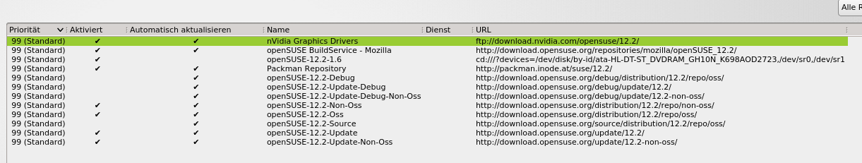

Poste mal die Ausgabe von
Das Lesen dieses Screenshots ist alles andere als bequem.

Hier mal die Ausgabe:
Alles anzeigenbernd@linux-yqdp:~> zypper lr -uP # | Alias | Name | Aktiviert | Aktualisieren | Priorität | URI ---+--------------------------------+-------------------------------------------+-----------+---------------+-----------+----------------------------------------------------------------------------- 1 | download.nvidia.com-opensuse | nVidia Graphics Drivers | Ja | Ja | 99 | ftp://download.nvidia.com/opensuse/12.2/ 2 | download.opensuse.org-Apps | openSUSE BuildService - GNOME:Anwendungen | Ja | Ja | 99 | http://download.opensuse.org/repositories/GNOME:/Apps/openSUSE_12.2/ 3 | download.opensuse.org-Extra | openSUSE BuildService - KDE:Extra | Ja | Ja | 99 | http://download.opensuse.org/repositories/KDE:/Extra/openSUSE_12.2/ 4 | download.opensuse.org-Stable | openSUSE BuildService - LibreOffice | Ja | Ja | 99 | http://download.opensuse.org/repositories/LibreOffice:/Stable/openSUSE_12.2/ 5 | download.opensuse.org-mozilla | openSUSE BuildService - Mozilla | Ja | Ja | 99 | http://download.opensuse.org/repositories/mozilla/openSUSE_12.2/ 6 | download.opensuse.org-oss | Haupt-Repository (Quellen) | Ja | Ja | 99 | http://download.opensuse.org/source/distribution/12.2/repo/oss/ 7 | download.opensuse.org-packages | openSUSE BuildService - Java-Pakete | Ja | Ja | 99 | http://download.opensuse.org/repositories/Java:/packages/openSUSE_12.2/ 8 | packman.inode.at-suse | Packman Repository | Ja | Ja | 99 | http://packman.inode.at/suse/12.2/ 9 | repo-debug | openSUSE-12.2-Debug | Nein | Ja | 99 | http://download.opensuse.org/debug/distribution/12.2/repo/oss/ 10 | repo-debug-update | openSUSE-12.2-Update-Debug | Nein | Ja | 99 | http://download.opensuse.org/debug/update/12.2/ 11 | repo-debug-update-non-oss | openSUSE-12.2-Update-Debug-Non-Oss | Nein | Ja | 99 | http://download.opensuse.org/debug/update/12.2-non-oss/ 12 | repo-non-oss | openSUSE-12.2-Non-Oss | Ja | Ja | 99 | http://download.opensuse.org/distribution/12.2/repo/non-oss/ 13 | repo-oss | openSUSE-12.2-Oss | Ja | Ja | 99 | http://download.opensuse.org/distribution/12.2/repo/oss/ 14 | repo-source | openSUSE-12.2-Source | Nein | Ja | 99 | http://download.opensuse.org/source/distribution/12.2/repo/oss/ 15 | repo-update | openSUSE-12.2-Update | Ja | Ja | 99 | http://download.opensuse.org/update/12.2/ 16 | repo-update-non-oss | openSUSE-12.2-Update-Non-Oss | Ja | Ja | 99 | http://download.opensuse.org/update/12.2-non-oss/Mit Netzwerk Manager das habe ich hin bekommen.

Du solltest wie gesagt als erstes mal die Prioritäten Deiner Repositories sinnvoll einstellen.
Das wird schon in diversen Threads hier im Forum erklärt.Die Repositories, die Du nicht unbeding brauchst, solltest Du entfernen.
Falls Du Repository #7 zur Installation des Original Sun Java RE eingebunden hast, kannst Du das entfernen. Dieses liegt dort nicht vor.
Die restlichen Repositories sind, abgesehen von den Prioritäten, in Ordnung.Den Rechnernamen kannst Du in
